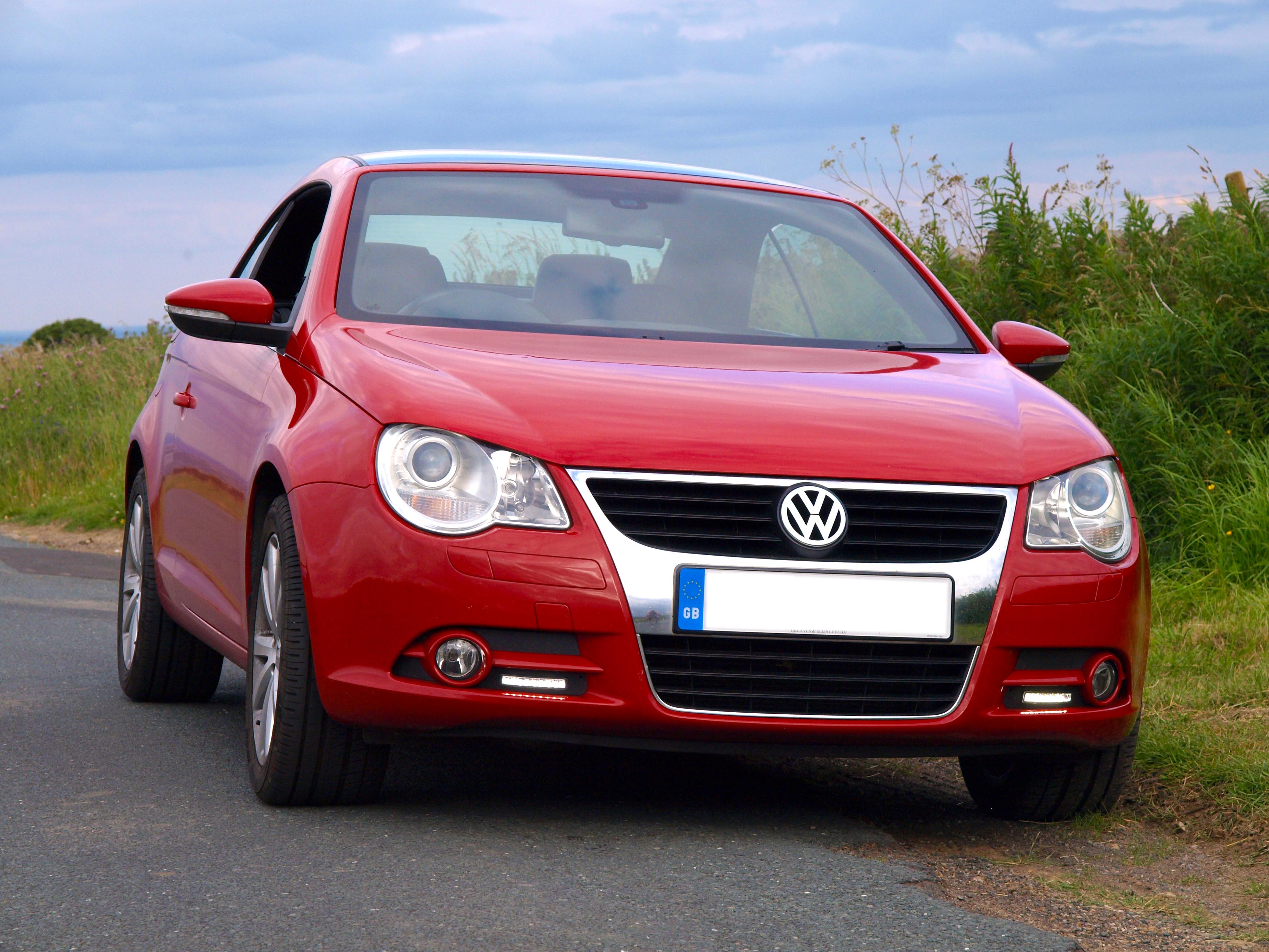

I've been toying with the idea of daylight running lights for a while now, and have done a fair bit of research to try and find the best looking and most reliable type.
Look on Ebay, and you'll find dozens at all sorts of prices, anyway in the end having done a lot of reading I decided upon Philips. Having had hub dynamo powered Philips LED had and tail lights on my bike which have performed brilliantly ( every pun intended ) and the fact that all the streetlights where I live have been replaced with Philips LED lighting, thought they'd be a safe bet.
They make several types, and I had initially decided upon the "Daylight 8" which dim rather than turn off when the sidelights are switched on, however not being too sure of the legality in the UK of having 2 sets of sidelights ( they recommend replacing the normal sidelight bulbs with dummies, something I didn't really want to do ) and the fact that these came out in 2010, I finally decided on the "Daylight 9" ( introduced 2014 ) which switch off completely when the sidelights
are on.
These are not exactly cheap compared with some of the Ebay "bargains" but it's a job I want to last, so thought it worth wile paying the extra.
Prices in the UK vary from £105, to the cheapest I could find which was Amazon at £75, however they're on sale in Germany for £54 with about £5 postage.
Needless to say I ordered them from Germany, and 2 days later they were delivered.

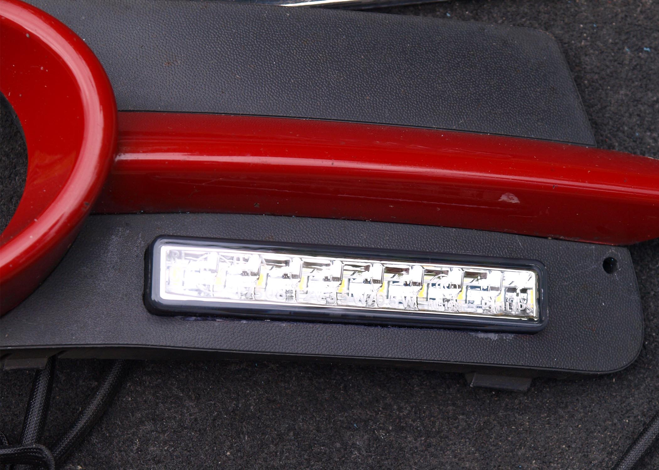

The obvious place to fit them was on the foglight covers, the lights come with metal mounts which are designed to be fitted into a grill, with the lights snapping into the mount. All well and good if there's a suitable grill, the one on the EOS is far to small and wouldn't look right or be legal as far as the spacing of the lights goes. ( 600mm minimum between the lights )
I really didn't want to have the dris protruding from the front of the foglight covers, preferring to flush mount them.

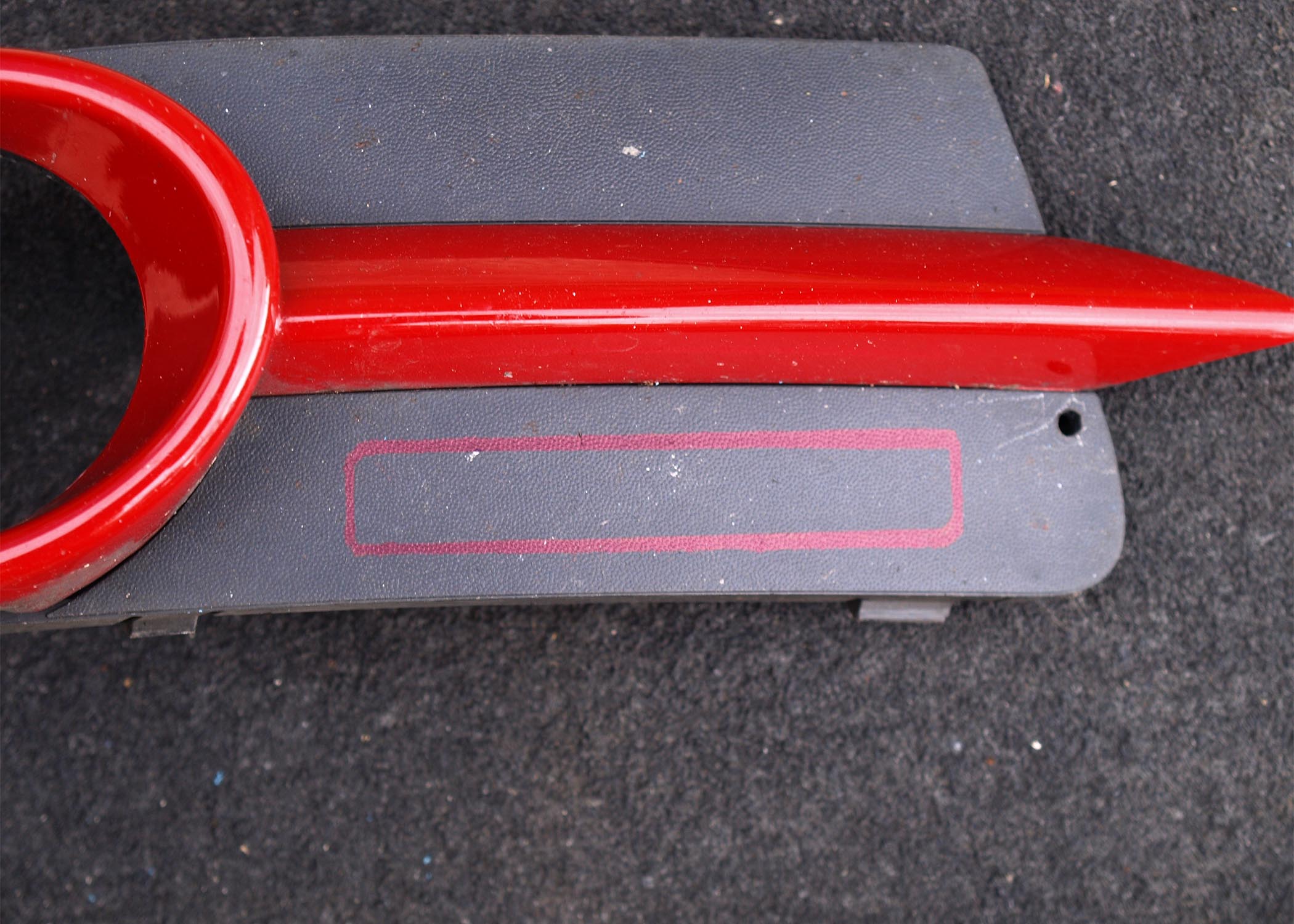

I firstly made a cardboard template by trial and error until I had the right aperture to accept the light ( they taper slightly being a bit wider at the front than the back, so the size of the aperture is critical to not have the light sticking out too much, or pulling right through.
I used the card template to mark the cover with a felt pen, then carefully cut out the aperture, firstly with a small cutting disk, and then a hacksaw blade. Finally filing to the finished size. I decided on the lower of the two positions, which still meets the minimum legal (European) height of 250mm.
After which the light could just be pushed through from the front, leaving about 5mm protruding.

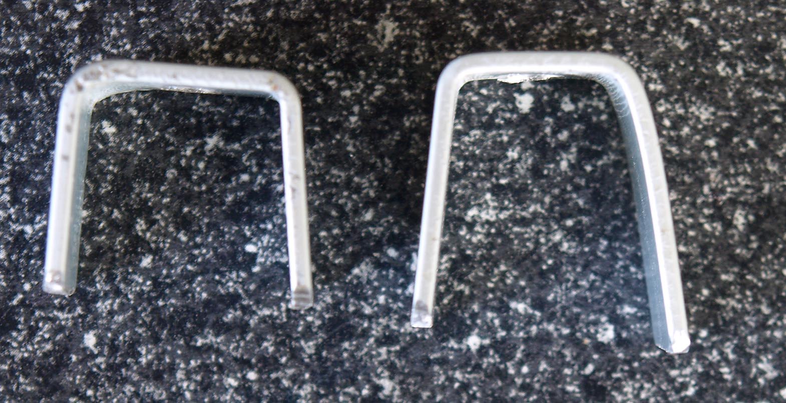

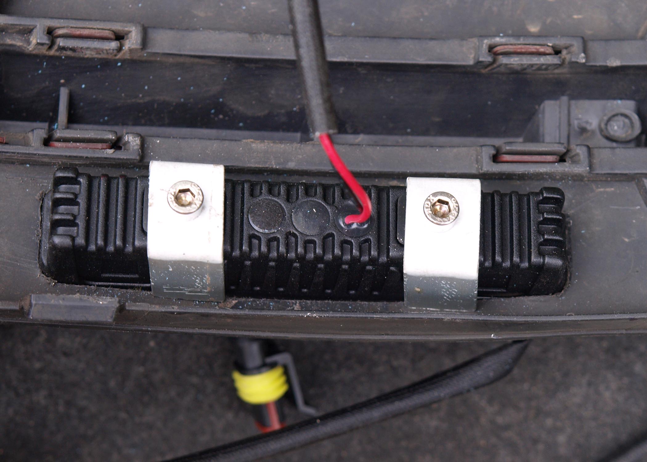

There are two M5 threaded holes on the rear of each light, so it was a simple manor to fabricate U shaped brackets out of aluminium to secure the lights into the cover.
The lights come with 3M of wire on the right one and 2M on the left, more than enough to route them through to the control box.
Bearing in mind that the covers will at some stage have to be removed for replacing foglight bulbs, I thought it prudent to bundle up about 50cm of wire with a tie wrap to the rear of the lamp to facilitate easy removal of the cover in future.

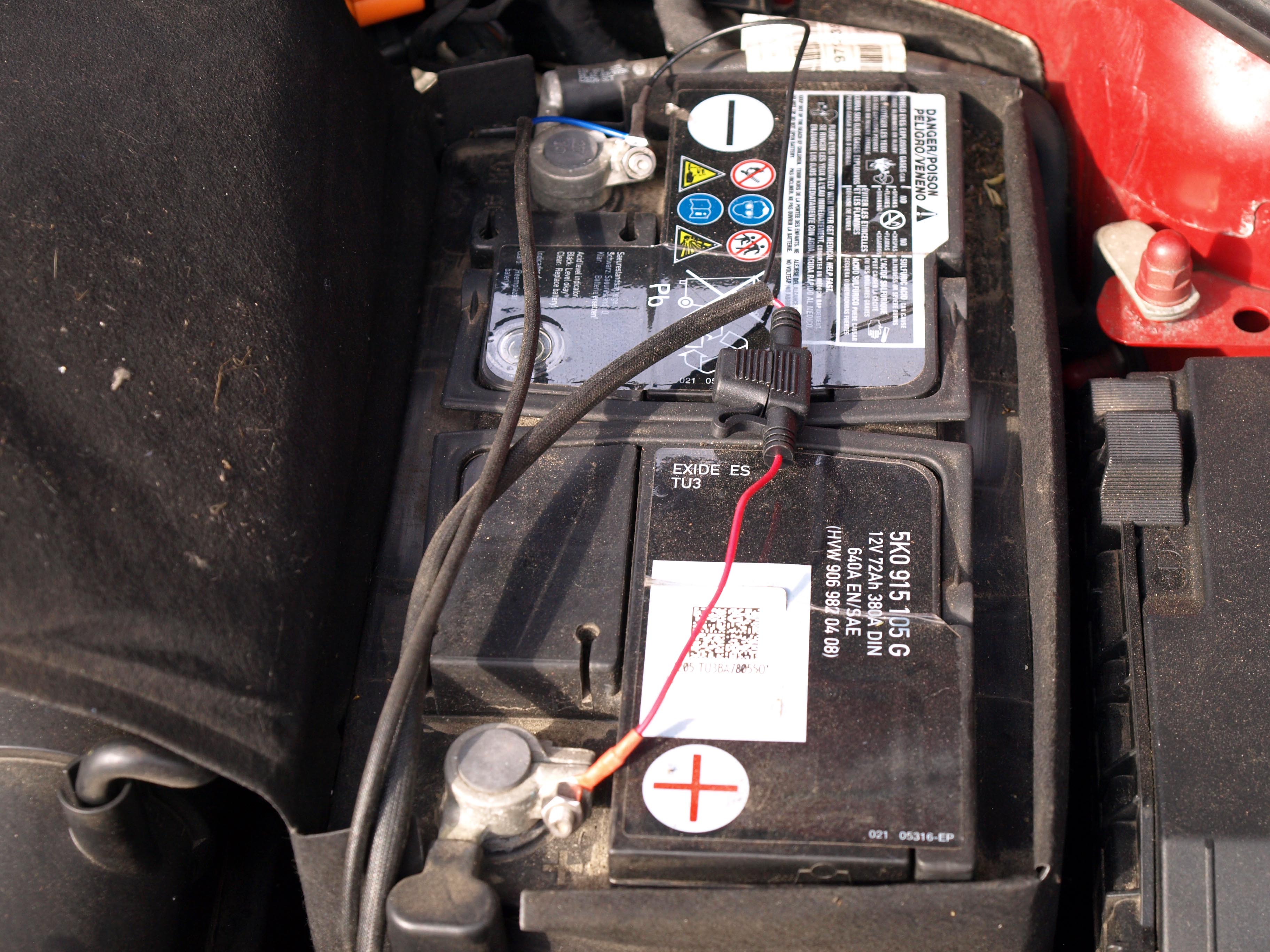

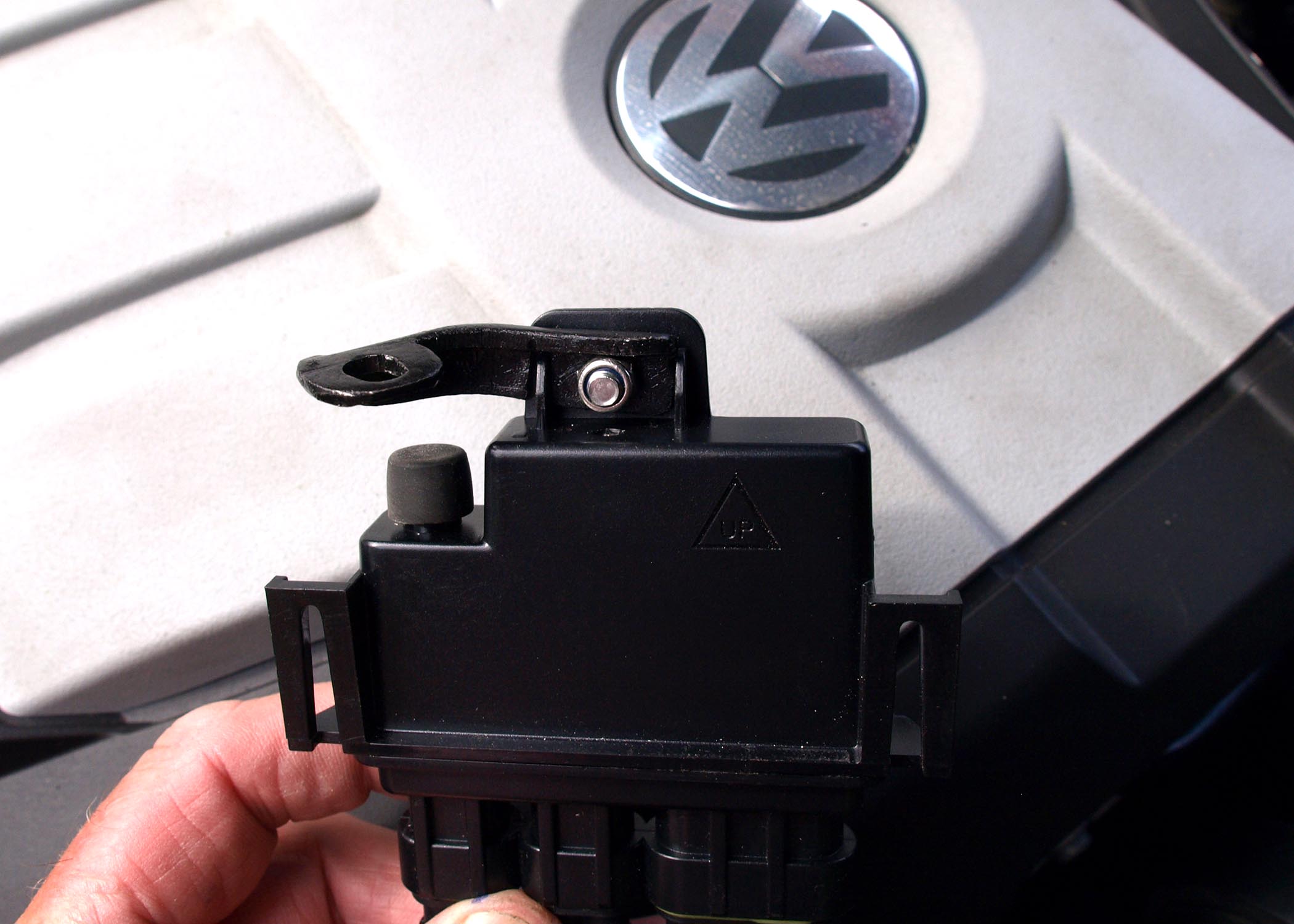

The wiring couldn't be easier, there's a small electronic control box which senses the voltage across the battery, so there's no need for switches. There are three waterproof connectors on the box, one for each of the lights and one for the power connections, simply a red fused wire which goes to battery pos, a black one to battery neg, a blue wire which also goes to battery neg, unless the car has start/stop technology, in which case it goes to vcc on the fusebox ( mine hasn't so went the battery neg)
There's also an orange wire which shuts off the lights when it "sees" 12volts this is connected by a scotch lock type connect to the sidelight wire on the headlight unit.
The hard bit was to find somewhere to put the control box, although being small, space is at a premium. I finally decided to secure it to the air filter box, so had to make a suitable bracket out of aluminium.

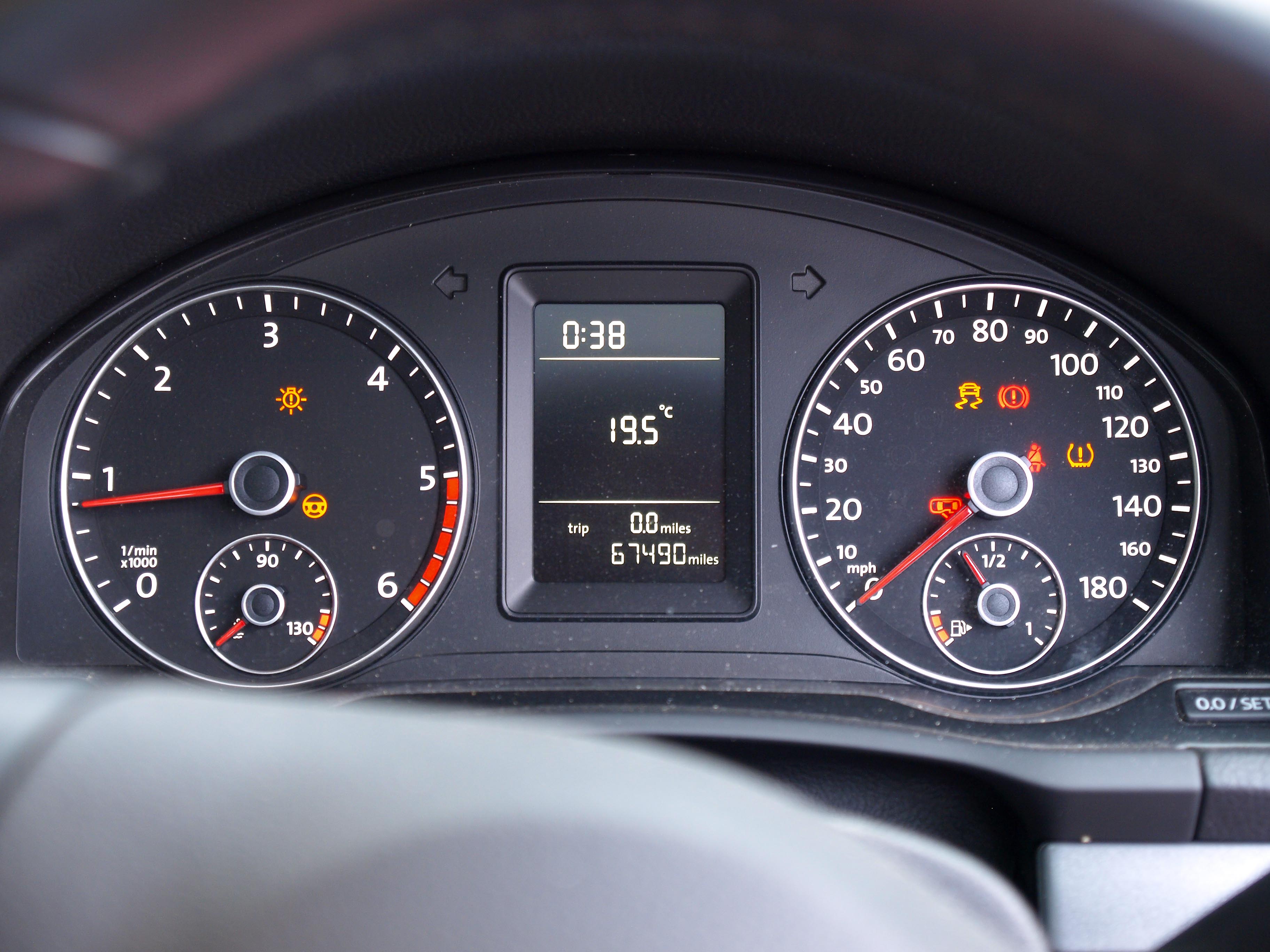

The instructions recommended that the car's battery be disconnected before making any connections, I was a bit dubious about this in case I lost the radio connection, not being sure if the radio code I have works. Anyway, I did as was suggested, and there wasn't a problem, however, when I re-connected the battery and started the engine, several of the warning lights stayed on, this I was expecting having seen something in the manual about it.
Anyway, after a 100 metre drive, they all went out again much to my relief!
As for the lights, they worked perfectly, came on as soon as the engine started, and extinguished when the sidelights are switched on. When the engine is turned off, there's a couple of seconds delay before they go out again.
Quite pleased with the visual results, though don't know whether they'd have looked better on the upper section of the covers, ( I was a bit worried of close proximity to the towing f eye )

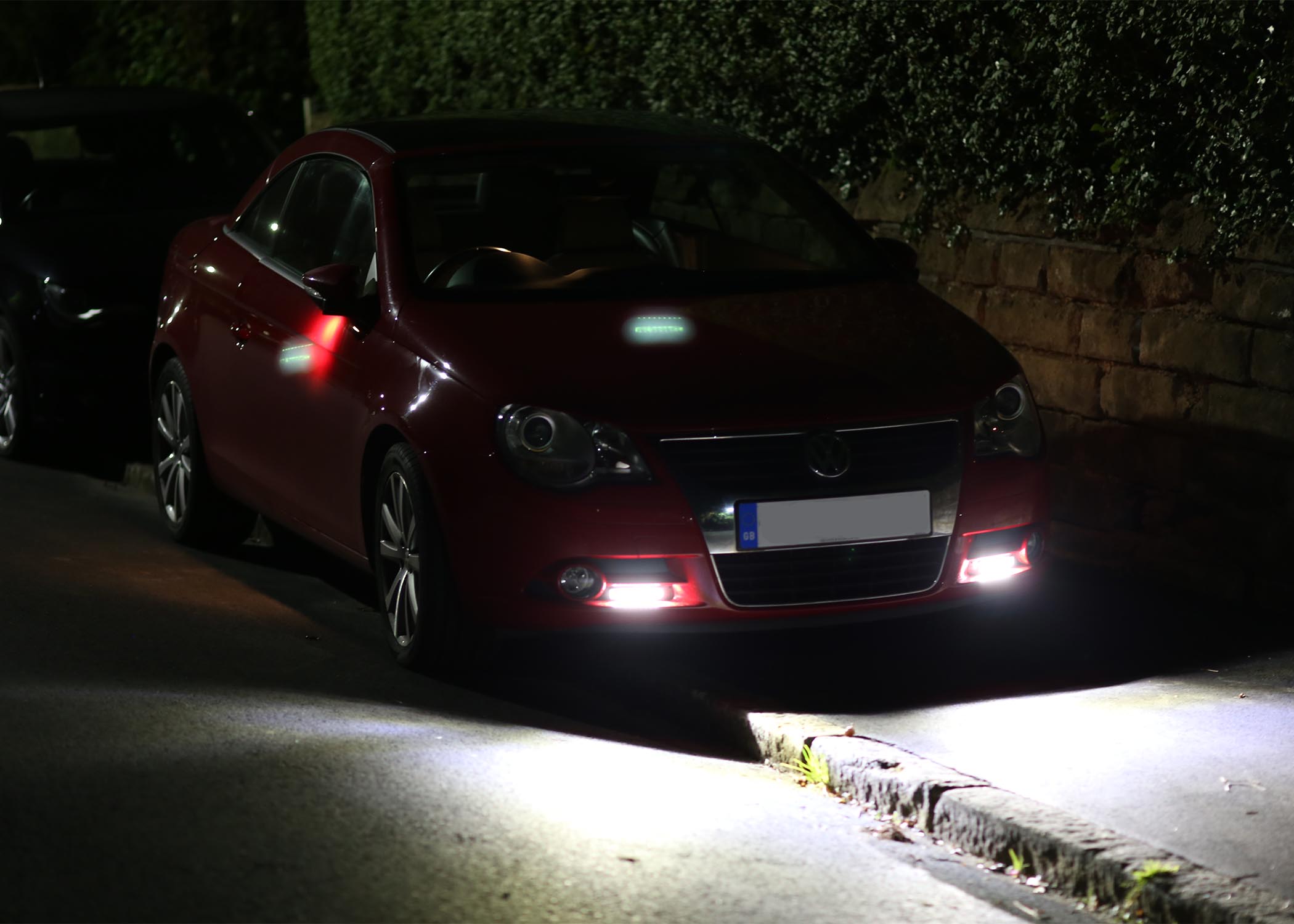

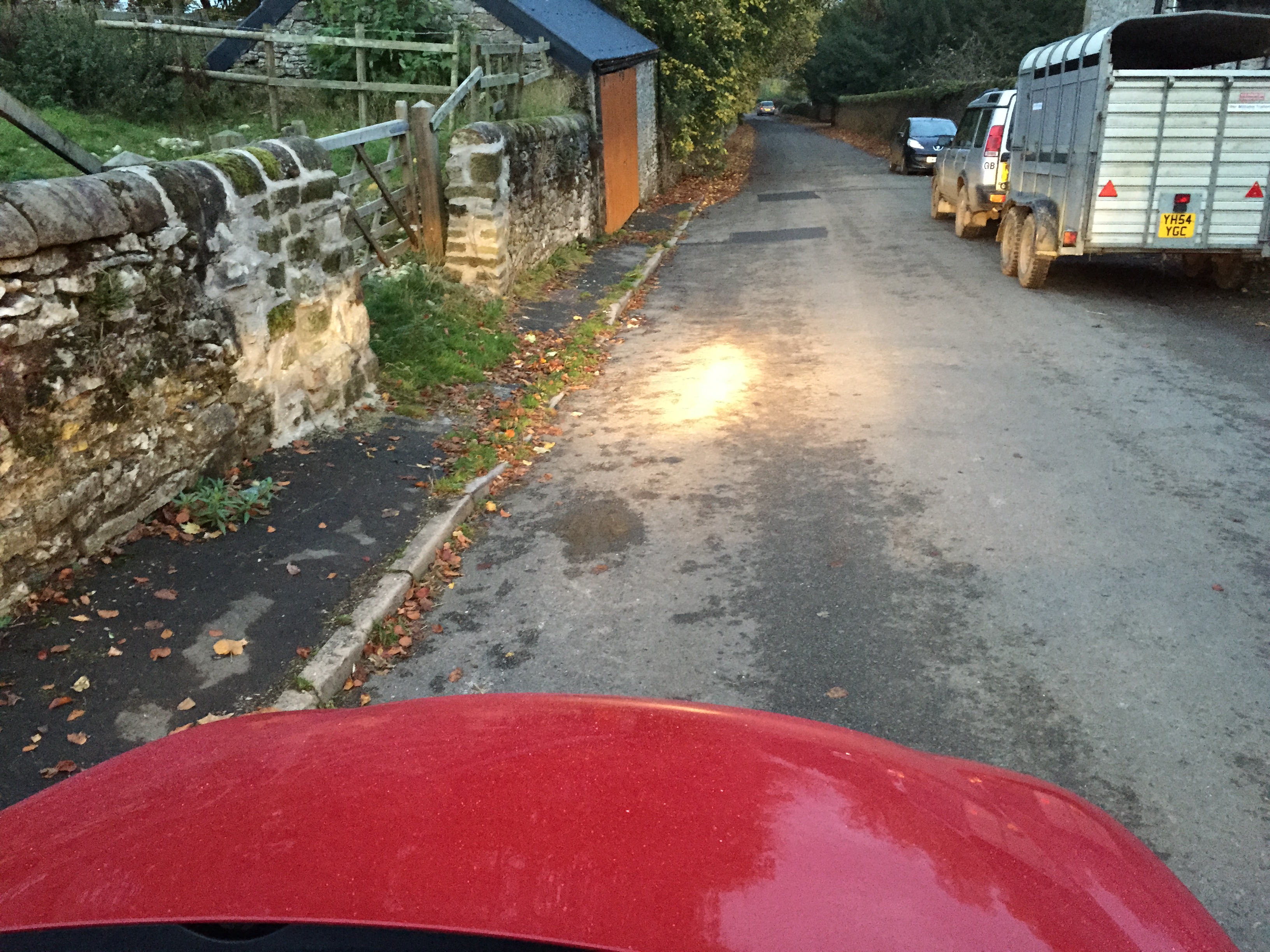

I was a little disappointed initially with the brightness of the lights, as can be seen by the picture above, however when you get down really low and look at them they're very very bright. Looking at the angle of them they're pointing slightly downwards, and putting a piece of paper in front of them, there's a very clean cutoff at about the height of the top of the lights, I'll heave to remove the panels and modify the mounts to angle them up a bit, as they're definitely pointing at the road, as can be seen in the pic below which I've just taken now that it's dark and easier to see exactly whats happening.

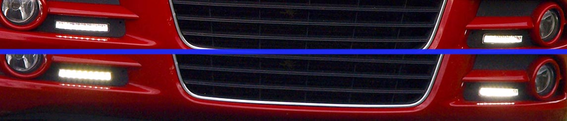

Decided to alter the angle of the lights up slightly as the foglight covers seem to slope inwards a little at the bottom, so made some new brackets with one leg longer that the other , the longer one being at the top of the light to pull it back slightly, thus angling the light upwards into the vertical position (new clip shown on the right of the pic)
Certainly made a difference, and the lights look a lot brighter now, difficult to show in a pic, but the image below shows the before (top) and with the new brackets (below)
All finished now let's hope the effort was worth it and they last the distance!

I can offer you a tidier solution to picking up supply from the battery which I discovered last week:
Remove the cover from the fuse box to the right and depending on your feature version, you should have some empty fuse holders. Use a voltmeter to find which end is permanent +12 volt. You can then get some thin copper sheet and make a single 1/4" blade to push in the hot side going to your fuse. Ignore the other side unless you fancy undoing loom tape to find out where the wire goes - but you could never be sure what they did with the end! You should be able to bring your fused hot wire out through a grommet on the side and there is a convenient slot on the right side of the fuse box to run one wire along. Your fuse should be inside the box with only a short wire to the blade for safety reasons.
For safety reasons, the fuse box contains NO ground wires and any added ground wire should be OUTSIDE the fuse box! You can either use the battery ground terminal just behind the fuse box or put in your own self tapping screw close by.
Making your DRL power connection this way means you don't have untidy spaghetti to deal with when swapping a battery.

as I stated in an earlier post, I had to angle mine up slightly to stop them pointing at the road.

Morning Pete, mine are fitted on the lower section near fog lights but the auto elec bloke did not cut the panel but fixed somehow without doing so, they consequently are not flush but they still do not protrude in front of the body work, if that makes sense! I am still very happy with the look + they are fixed in place solid. Tek care. Rick.
__________________
TFSI sport 2.0 my2006 midnight blue. cream leather interior. heated seats,heated mirrors. 200bhp
Kaff37 is offline   Reply With Quote
Old 08-02-2015, 08:39 AM   #10
Kaff37
YORKSHIRE PUDDING
Join Date: Jan 2014
Location: WEST YORKSHIRE
Posts: 141
Default
Sorry Pete, the lights are horizontal . Rick

Just had another look at your DRLs Pete & mine are in the exact same place only not flush. Rick.

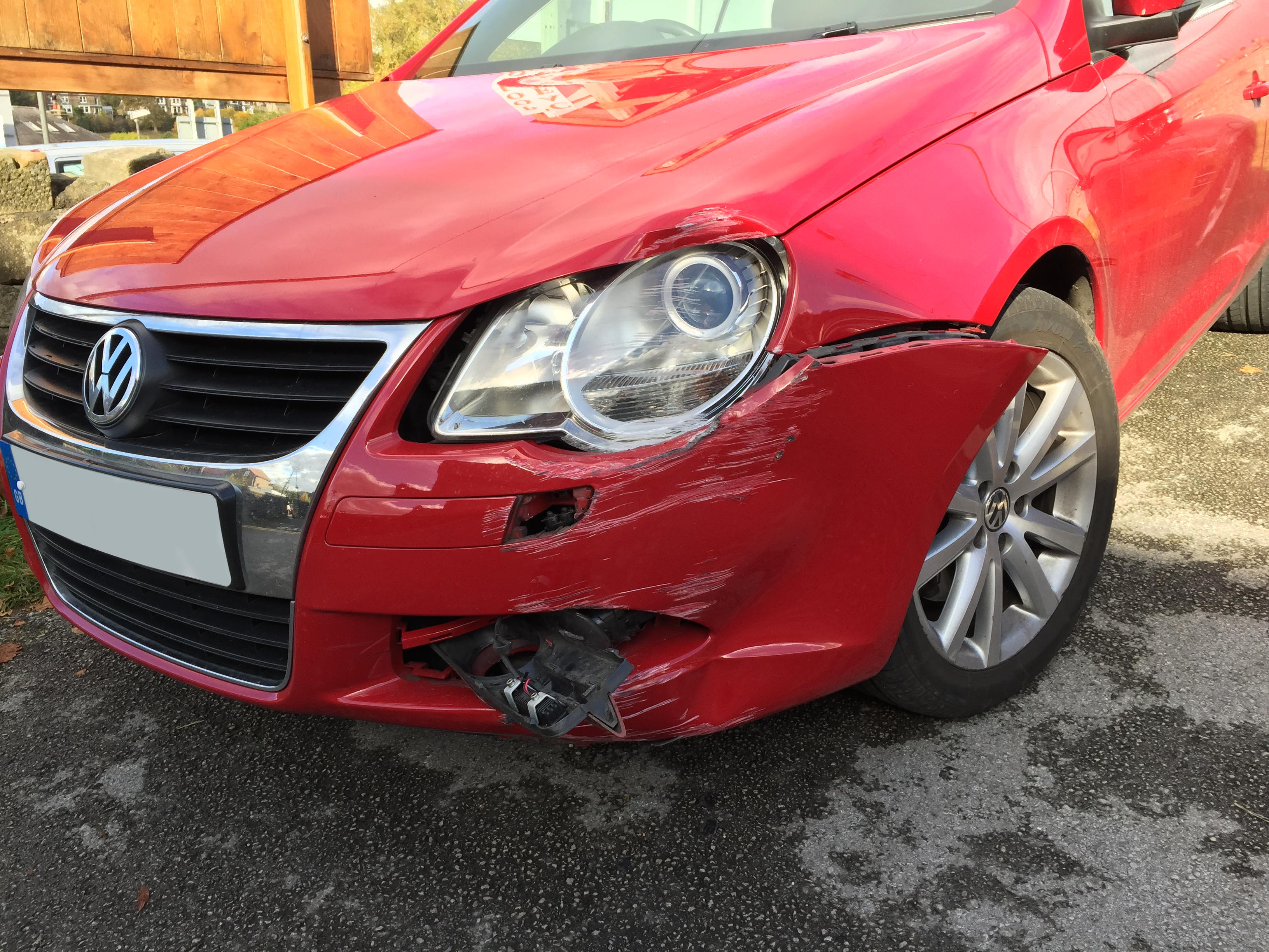

As far as the foglights go, I think Hella make a set of replacement foglights which contain both foglights, which are switched as normal, and the drl which is effectively a ring around the outside of the fitting, and which, I presume is connected so that they come on automatically with the ignition and dim/switch off with the sidelights.
The bad news is that they won't fit on the EOS, I think they're too big, and also the EOS lights have an angled glass on the front to follow the body contour, so they're right/left orientated.
I've been very pleased with the Philips lights, but sadly they're no more!
No fault of the lights, they were brilliant! I don't know how, 'cause I'm usually very careful, but I either didn't set the handbrake properly, of it slipped, anyway the car ran down a slope and into a wall causing a couple of thousand pounds worth of damage. I removed the lights and associated electronics before it went in to the body shop, so it will be a re-fit when I get it back. I'll probably fit the old foglight cover on the undamaged side, and just cut another hole in the new one on the repaired side. All in all a very expensive hassle!
Incidentally, the repair shop said they've had at least 15 similar incidents regarding VAG vehicles, they said there's a known problem that after heavy braking, the discs expand, then when they cool, the callipers are not so tight, so may slip! Why VAG vehicles should be any different i don't know. Their advice was to pull up the handbrake up as tight as you can, then try for an extra click, and put the vehicle in reverse ( something I always do, but for some reason didn't on this occasion)
The drl survived the bump without a scratch, they're very well built, with thick glass not plastic fronts. ( see pic )
C'est la vie! Thank goodness for a good insurance policy with protected no claims!!

Got the car back at the weekend, the body shop had done a fabulous job, perfect colour match, took a while because the first, and second bonnet (hood) they got were damaged, so had to get a third! looking at the list of parts fitted, I noticed a new headlight washer jet and valve, I never even knew there were washers fitted!!
Anyway, all was well until the night time. when I used the headlights, only to find that the new left hand headlamp (£190) was pointing to the ground on full beam. The dipped beam was fine, and moved up and down in tandem with the right hand side when adjusted with the dashboard control.
On examination, the bulb was not centred properly, but hardly enough to make it shine on the ground a few metres in front of the car.
Took it back to the body shop where the guy looked at it, and on removing the full beam bulb, the reflector could be moved about by putting his finger in where the bulb went!
Anyway, he's ordered me another new lamp unit, so hopefully that'll do the trick.
The bill came to £3070, no wonder insurance premiums are so high!

Default MY07 EOS TDi Philps DRLs Part 1 of 2 posts
Thanks to previous posters for their contributions which persuaded me to do this. I'm not a fan of aftermarket farkles which can be poorly designed, finished and rarely up to OE quality. Getting the best result from the Philips kit is definitely not easy 'plug and play'- level 7 on a 10 point dificulty scale to do what I did. Daylight Running Lamps (DRLs) are becoming standard requirements for new vehicles. Their objective is to use the higher color temperature leds to stand out in daylight, making your car more visible to pedestrians and other road users. They are not for adding more light and in my personal opinion should not be aimed at the road surface.
Legal DRLs like these are rated at 3.5 watts per lamp unit, although the overall power taken is around 10 Watts. Being bright and aimed at eye lines, they could blind at night and their use at night is forbidden. Philips provide a control box which delivers constant brightness whilst allowing the DRLs to be lit only when the engine is running AND no other lights are on.
I bench tested my kit before install because some posters were concerned about current draw or flattening batteries. The DRLs power on at about 13.5 volts and are off at 12 volts. If the lamps are forced on at 12V a pair take 0.9 A (12W). At 14.5 volts (alternator charging) current draw is 0.7A (10W). When the DRLs are 'off' the control unit draw is 3mA. This small current should not significantly add to battery drain. I have a particular problem because I have added a 12 volt external charging point for a 24/7 tender. MY07 is a second car used less frequently and I can't have the DRLs lighting up when my battery reaches full charge on the tender. Also a new battery with high terminal voltage might cause the DRLs to stay on for a while after stopping. I didn't like adding skimpy wires to battery terminal posts and my solution connects the DRLs to an 'ignition on' power feed inside the main fusebox in the engine bay.
The Daylight 9s are a universal kit. Like most kits, their design and supplied parts would not achieve an OE quality installation. This is some of the extra work required and kit short comings: 1. A custom bracket to secure the control unit (they could have supplied it with heavy duty velcro pads). 2. Make a paper drilling template. 3. Buy piggy back standard ATS blade fuseholders with 2-3 Amp blade fuses. These allow an empty fuse slot to be connected to a wire, or provide a second fused outlet to a wire if a fuse slot is already filled. 4. Make plastic 'wedges' to create an upwards aiming angle. 5mm raised along one edge worked for me. The orange wire from the controller has to be connected to a side lamp feed to turn off the DRl's when lights are on. I hate Scotchloc type joins and crimp splice connectors. I always solder and heatshrink sleeve over. Use butt crimp connectors by all means, but for a neat reliable and waterproof job, butt solder and heat shrink sleeve.
Flush mount or surface mount? From conception this kit is designed for surface mounting. There is no front bezel to tidy up an untidy cutout on the EOS ABS fog panel and you only get one chance at a neat job. If you want to remove the DRLs you will have a large rectangular hole to repair or replace both mouldings. The DRL's come with spring clip brackets. I saw no point in them and I'm always suspicious that these exposed parts are the first to deteriate in weather. Each lamp unit has an M5 tapped hole at the back. DON'T fit a clip if you aren't using them, they are hard to remove! If you flush mount there will be less air circulating behind to cool the lamp modules. Their diecast heat sink is pretty substantial, but it will work better in moving air. The fog panel is not vertical and has a slight downwards (and curved) surface. To get best visibility when fitted low on the EOS fog panels they need to be angled upwards. If the units are flush mounted they sit back and when angled upwards will be screened by the painted front molding. Everthing therefore points to surface mounting for best results - They are small and do not project in front of the painted cover. I think mine look fine. Philips dropped off with mounting options. Had they included tapped holes at each end of the unit, a clip on bracket fixed at the sides would have allowed the angle to be set when fixed to sloping surfaces. My solution was to make some taper wedges and fit them under the mounting screws.
Top or bottom slot?
My personal choice was the top slot. Being a little closer to the headlight they look right belonging more to the headlight than the fog. I was also aware of lifting up the angle and wanting more height. I don't think the towing eye will be an issue in the right side. I've never ever used one and our breakdown people don't use them.
Preparation is 80% of the effort:
Tools: Torx driver for front grill, 5mm, 5.5mm drills, electricians 'mouse' to re-thread their wires through sleeves. Sheet metal, soldering iron solder and heat shrink 4.2,6.5mm ID. blue crimp eye for chassis ground. Black silicone to seal cable entry through fog panel.
1. Before you start: Open the kit and mark each DRL left, right and top on the back. Right side has the longest 3M wire and assumes the control unit is mounted furthest away on the left near the air box (UK Model). Each lamp lens is marked on the front and the lettering must not be upside down! When you remove each fog panel molding, mark them on the inside 'top' right and left. It is very easy to get them upside down and start drilling the bottom slot instead of the top slot. Lay each DRL on its respective molding. Note that whilst both units have the same M5 bolt positions at the back, power wires come out to the right and left of the center line in different positions each side. Both lamps have the same codes and I think it's only wiring length making them right and left. Continued post 2

2. Access and trim removal: You don't have to remove the bumper! Remove the front grill (2 screws at top on lock cover, 2 screws up underneath the bottom grill). Remove the air filter cover screws and prop open with some wood. Each fog light trim is in 2 parts. The outer painted trim is fastened by fragile wedge clips to a black ABS carrier, parts of which you see as the black slots. Keep the painted trim and black carrier as one piece, always resting the painted side downwards on to a towel or when drilling holes. Removing the fog trim can be a pain. In the trunk there's a funny hook tool. In principle you hook this through the small hole in the black cover and pull. If you are lucky, you will hear a click as one wedge clip releases whilst the others stay firm.
I've attached a photo of the carrier showing the position of all 6 wedge locks. Do NOT lever up against the painted molding, you will probably destroy its fragile fixings and require JB Weld! Using a thin blade locate the nearest wedges and push them downwards to release their claws. Work all the way around, holding the circular painted part and pulling helps, but don't force using a tool.

5. Make the control unit 'L' shaped bracket and check it fits the corner screw on the airbox cover.
6. Make 4 plastic wedges which will kick up the bottom long edge of each unit 5mm.
7. Remove parts of the kit you don't need. a) On each drl, cut off the 2 pin power connector, leaving about 50mm of wire to re-splice, then pull the sleeve off and keep. Cut off their inline fuse holder. Cut off their terminal on the black wire. Discard their spring fixing bracket. Discard most of their fittings, except tywraps.
8. Using my template as a guide for drilling the top slot or make your own, locate it on the back and mark the drilling points with a sharp point. The template can be reversed, check it is the right way around, in the top slot and mark the correct location for the wires. Place the correct lamp on the front and check the marks are correct before drilling. Drill the 3 holes 5.5mm, pass the power wires though and seal the hole with silicone. Repeat for the second lamp. I cannot stress you must get the correct lamp with the correct moulding both with their top marks to the top and drill the top slot.
9. From my photo, locate where I made a chassis ground, drill and fit a self tapping screw. You will use this instead of attaching wires to the battery post.
10. My fusebox had a spare unused section at one end where I was able to drill a hole in the corner and bring in the DRL power wire. If your fusebox is packed with wiring you will have to work out how best to do it. Drill the hole.
11. Philips supply plenty of wire and sleeve. Start with the longest run right side. I rested the fog surround on a towel on the ground just in front of the fender on the basis I wanted sufficient length to be able to drop the front plastics down without pulling out the DRL wires. Test run the right side wire across the front behind the grill and hidden. Allow an extra foot to the control box and cut to length. Shorten and replace the sleeve, then solder splice back their 2 pin connector. Repeat for the left side DRL.
