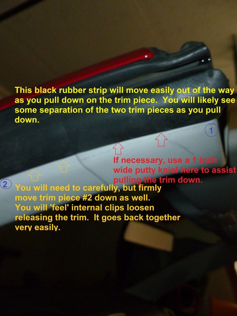

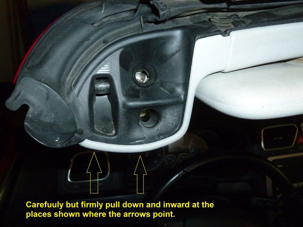

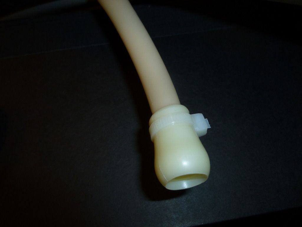

We just purchased a 2008 Komfort 2.0 TFSI Eos. It is a fun car. We, too, had the leaks at the A pillar on both sides. Using the great information posted here I was able to gain access to the tube and collar and make repairs. Here is how I did it:
The A pillar trim is actually two pieces. There is a top corner piece and a longer piece that runs the length of the pillar (the one with the vent opening in it). Begin by pulling the top corner piece down and slightly inward. Pull firmly but carefully....it will move!
As the corner trim comes down the seam between the corner trim and length-wise trim will become obvious. Just keep working the two pieces downward to get room to access the tube.
When you can see and access the tube you can work the plastic collar off its mounting point. Note the plastic tube in held by a clip but it will release the tube fairly easily. Once you have the tube out of the clip and collar loose from its mount just carefully pull the tube and collar out so you can work with it.
On my car, the tube was clearly NOT in full contact with the collar creating gaps that allowed the water to leak. But, the tube would not pull free of the collar and I did not force it. My solution was to put a cable tie around the collar.....no glue, no tape, no hot wax, just the cable tie. It seems to have worked. I washed the car after doing this to both sides and no leaks! I'll give a follow-up report down the road but it seems to have done the trick!
I hope this helps!

Thanks that's a good illustrated write up for a problem several have found.
However, I will add something that isn't obvious when you see the trouble VW have gone to designing in drains in the first place:
If your roof and sunroof seals are making good contact and sealing, you should not get water into the 'drains' in the first place. The drains are like a bucket under a leaking roof! The unlikely exception is if you were driving in rain with the sunroof open.
When you get water leaking from the 'A' pillars (hose) the first thing to do is go around all the roof seals with thin paper checking for seal to seal contact pressure. The common weak point seems to be the front left and right corners of the sunroof glass seal which can take up a permanent 'set' pushing the seal corners back towards the holding flange. With patience you can work in Krytox massaging with your fingers and pull the seal forwards from the flange a little. Then do my 'river of water' hosepipe test over the roof, or run the car through a car wash. I did phone my local human operated car wash and asked if its program could be set for just rinsing without the brushes which they said was possible.
